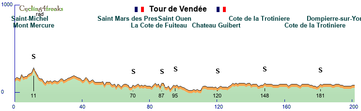

Has anybody found good information on the Tour de Vendée? I could try to design it using the information I found on their webpage (https://www.tourdevendee.fr/la-course/i ... -horaires/) tomorrow, but it would be far from perfect.

Seeing Radunion started designing Vendée. Let me know if you plan to finish today/early tomorrow ? Because I think I need to upload tomorrow morning for inscriptions... If you don't have the time, no worries, then I use an old version.

Post by Radunion » Wed Oct 08, 2025 8:51 pm
Hope to finish Vendee today. I will not be perfect, as I am not willing to do the circuits in the end, as each one is different, and it is flat anyway.
Radunion
Posts: 607
Re: October 2025
Post by Radunion » Wed Oct 08, 2025 9:16 pm
Not much to do as it is flat apart from the one hill in the beginning that could be 5 or 6 (went for 6). Kept the intermediate sprints even if it means a lot of money in-game. As mentioned, the final is a multiple different flat circuits. So I did not make the effort to reuse identical parts.
