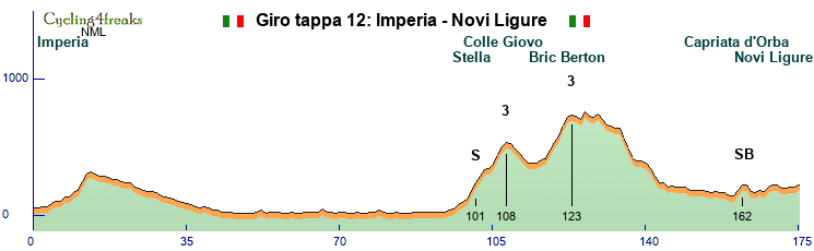

Re: Giro d'Italia 2026

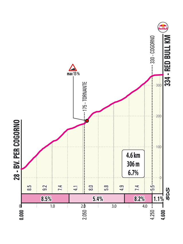

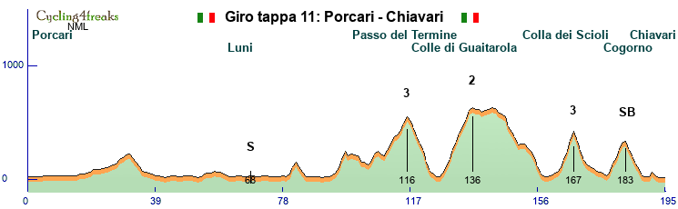

Stage 10 ITT done, very flat, Rinchiostra is 0 - 2 - (-1) - (-1).
Stage 11 +12 also done, feel free to review the climbs, gpx was kinda wrong on the climbs there but climbfinder + official infos + La Flamme Rogue had good information
last climb Cogorno 9 - 6 - 7 - 6 - 2
Capriata Dorba 4 - 4
Bric Berton 2 - 1 - 6 - 6 - 5 - 8 - 5 - 2
finish 1 - 0 -2
finish 1 - 0 -2

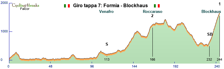

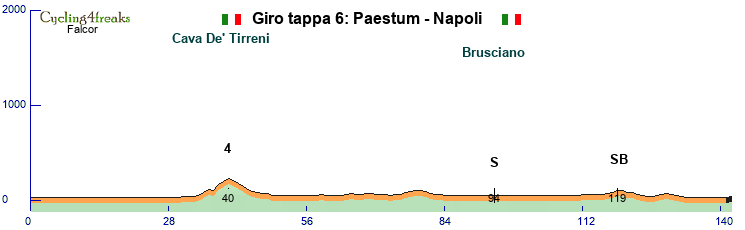

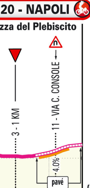

Stages 5,6,7:
Not much to add, last 6km looked very weird from the gpx, other designers and myself unanimously decided to change it to how it is now (6/3/-5/-2/0/2).
First 141km not much there to discuss, but for the final km we would like your feedback. Looks like this:
So 300m regular flat, last 700m is on pavé (*). Around 500m long 4% ramp (all on pavé), but last 200m are flat again, still on pavé. Dilemma now is between 1* and 2*. 17m height difference over the whole km, but those mostly come from the uphill part in the middle. We are leaning 2* now, but would like others' feedback too.
Again not much here, mostly Blockhaus climb important. Not climbed all the way to the top, gpx file pretty much matched the climbfinder profile, so generally didn't have to change much this stage.
Let me know if I missed anything!

Hm,
Roccarosos GPM is too early also, 1245 altitude. Also cat 2, not 1
You have 2x 13 in there. Check "climb details" on the Giro site, no 13%. Cyclingcols very similar to the Giro details, both good sites (and both annoying at times with all the mental calculations you sometimes have to do)
Huh, was struggling to find the right percentages for Blockhaus, based myself on gpx+climbfinder (per 2km). Used the giro site climb profiles in all stages but didn't think about using it here for some reason. Weird... Good catch!Robyklebt wrote: ↑Fri Apr 24, 2026 4:13 pmHm,You have 2x 13 in there. Check "climb details" on the Giro site, no 13%. Cyclingcols very similar to the Giro details, both good sites (and both annoying at times with all the mental calculations you sometimes have to do)
Same for Roccarosos, not sure what went wrong there. KOM now 1km later, in reality even a few 100m further, but whole km would only be a 1%, so prefer to have it 300m earlier instead.

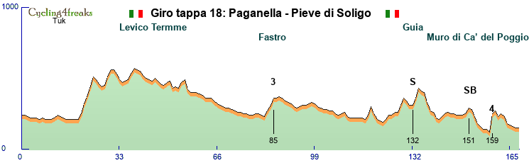

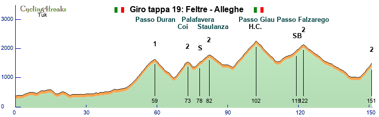

Stage 19:
Stage 18:
Climb is a little over 1km and since it is a little bit over 12% on average too decided on 13%. Final km at 0, even with -0.6% over the km. But the final about 150m are uphill again so I feel like the sprint itself is matched better with a 0
Stage 18:

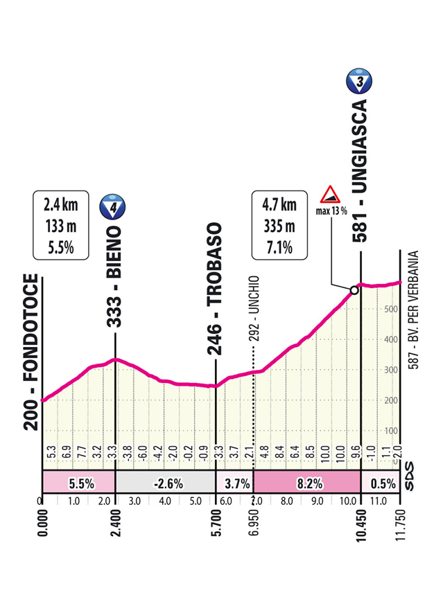

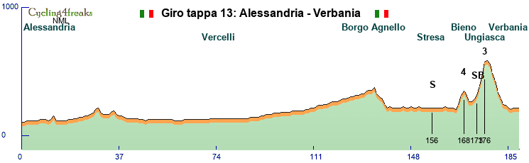

Stage 13, 2 climbs at the end
Bieno 2,5km climb 4-7-3 (the first km reflects the 0,5km flatter start (5,3% Giro & 6% La Flamme Rogue to 4%))
Ungiasca 3.5km climb from Unchio (RB Sprint) 3 - 7 - 9 - 10 (the first km reflects the 0,5km flatter start (4,8% to 3%))

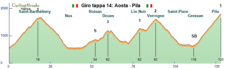

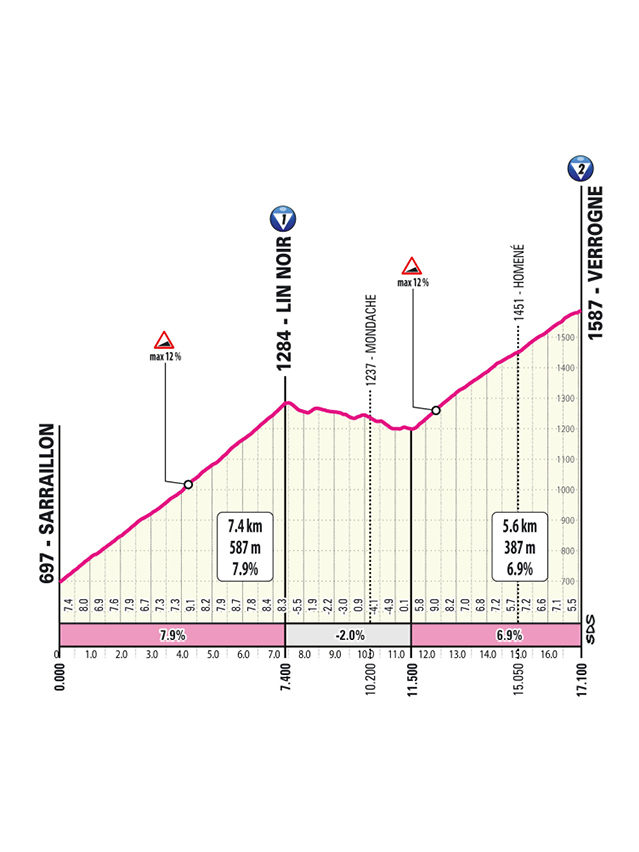

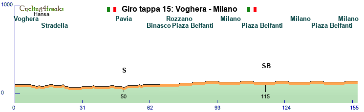

Stage 14
a bit tricky with the climb up to Verrogne as the first part up to Lin Noir is 7.4 kms and the 2nd uphill part is 5.6 with 4.1 kms slight donwhill in the middle. i decided to underdesign the first part of the climb by 400ms and 37 HM and overdesigned the 2nd part by 400ms and 33 HM. other interpretations are pretty much possible but that was the one i decided for, but that can be discussed.
Stage 15 pretty flat, some laps in the end with 16.3 kms 4 times thats why we lose 1 kms there i just added a 0 at the end to make up for that.

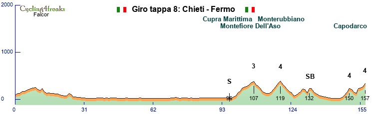

Stage 8:
Stage 9:
Both climbs quite different from the gpx, based on the Giro site profiles.
Last stages from me. Any feedback for stages 1-9 is free to be sent in my direction. Once Tuk finishes stage 17 we should be done with Giro.
One more thing: Maybe better to wait with publishing until at least 30/4, to avoid new teams signing up already and going out inactive.
Stage 9:

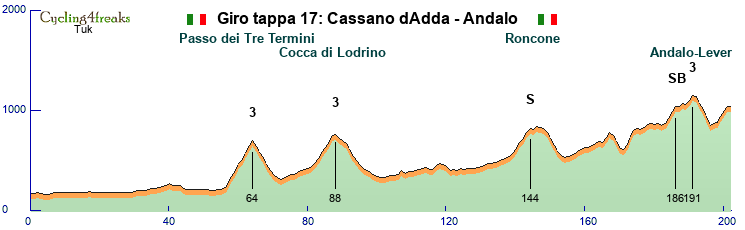

Stage 17 also done now

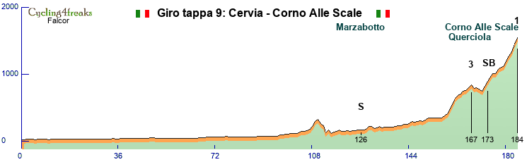

Stage 9:
Redesigned the final climb. Mistakenly thought it was 10.3km climb when it's actually 10.8km. So, last km is in reality only 800m now, but think that is completely fine here. I work from the top to the bottom of the climb when designing. Did from km to km (10-9, 9-8, 8-7 and so on), but now noticed in the climb detail on the Giro site that it started with .5km, then 10 full kms and then 300m (hence the earlier confusion, didn't factor in the extra .5km at the start. So, redesigned now, starts with the last 800m at the top, then full kms before that. Final 3kms now 12-11-7. 12% is still debatable. It is actually from 2.8km until 1.8km, not 3-2. Km3-2.8 actually almost completely flat, hence the design here is 2% steeper, since that part is included in the km before. Could do the third last km according to the final kms info on the Giro site, which would put it at 10%, but then the kms before that are hard to set, so will keep it like this for now. Fourth last km goes down from 8% to 5% because of the other design way, rest of the climb also different. Check it out and let me know what you think
Edit: Giro site profile is wrong. It concerns km172-173, with km173 being the Red Bull km (SB). So now not even sure if that km is actually uphill or not, hard to tell. Did some stuff there to make it match, now we end up at 1489m, 18m higher than reality, which seems ok since we have 200m more on the climb.

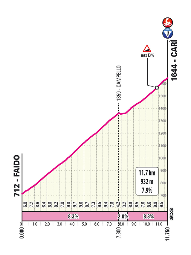

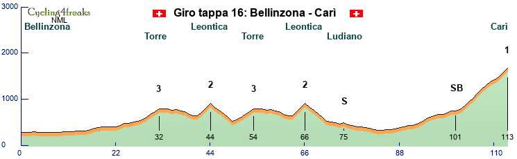

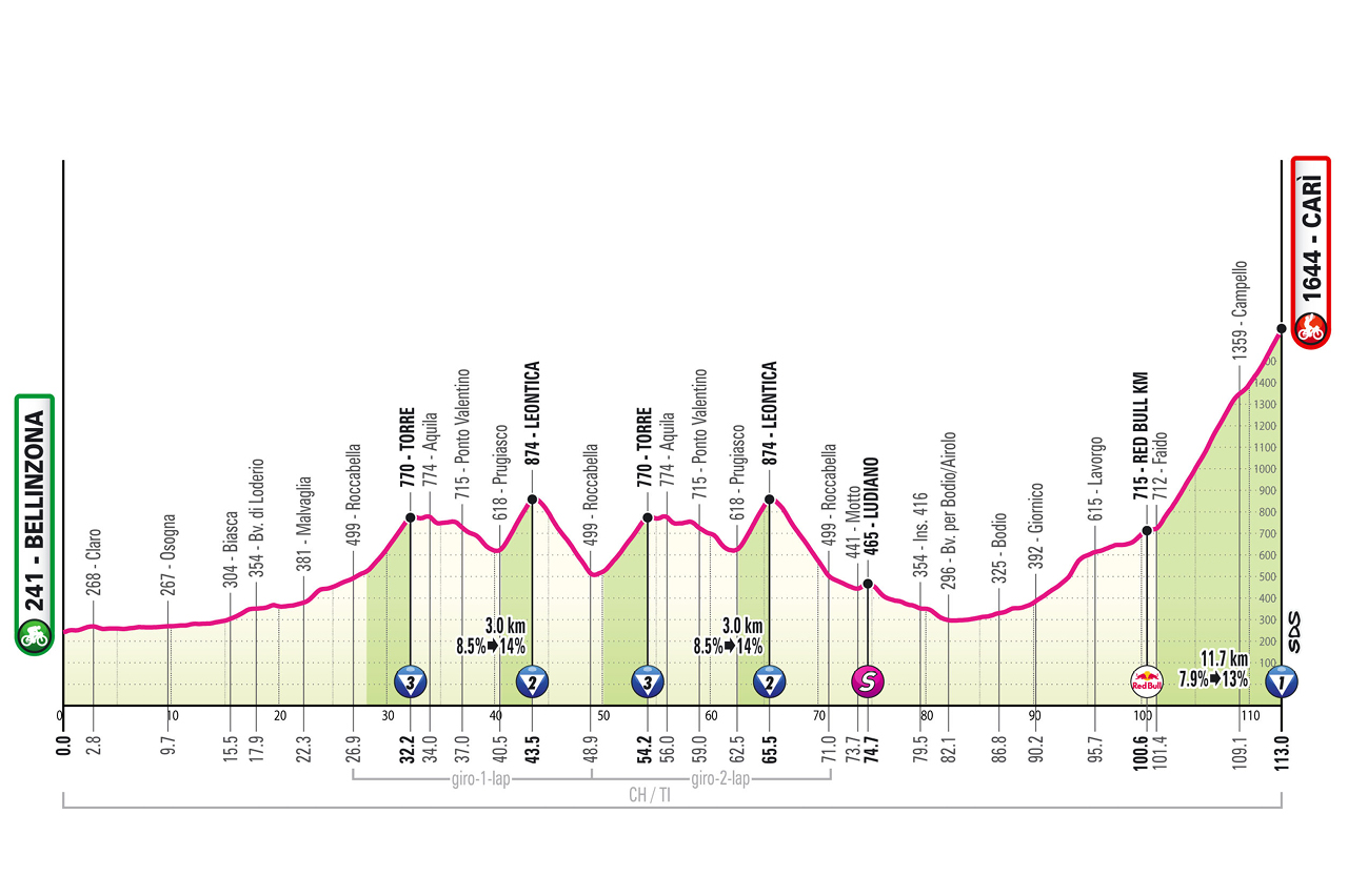

Stage 16 done, 1 climb big climb at the end, 2x 22km laps in the middle with 2 small climbs
Torre (5km) 3-4-7-6-7
Leontica (3km) 9-9-8
Cari final climb (11,7 km -> rounded to 12km and adjusted the start of the climb made it flatter)
3 - 8 - 8 - 10 - 9 - 9 - 8 - 4 - 7 - 9 - 10
For the climb I started from the top to the bottom, because its not exactly equal I took the share (in m) of the climb with the % and calculated the average % of each km with the details from giro website. For the last km f.e. = (250m*9,9%+750m*9,5%)/1000m = 9,6% (rounded to 10%) (thanks to hansa here btw for the idea)
Feel free to review it and share your thoughts.
I guess we are at 21/21 then?

Thanks for all the effort NML.
You can make the last (Red Bull) mountain of stage 11 harder, to get closer to reality. "last climb Cogorno 9 - 5 - 7 - 6 -1" your average is 5.6% over 5 km
Actually it is 6.7% over 4.6 km
If you make it: 9-6-7-6-2, or 9-6-7-7-1 you arrive at 6% over 5 km, which is more realistic.

Hi Hoefs, good catch. I think 9-6-7-6-2 makes sense as for the 2nd km its 11,5%/2 anyway and the last part is only for 400m kinda flat. Adjusted it,thx.Hoefs Cycling Team wrote: ↑Wed Apr 29, 2026 9:00 pmThanks for all the effort NML.
